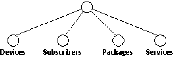

In this example, the directory for a pay TV company stores information about devices, subscribers, the packages they subscribe to, and the services included in each package in separate places in the DIT:
The DIT in this example includes information held in four different locations of the tree
The structure of this directory makes it simple for staff to navigate, but it is not easy to find information about the services associated with a particular device.

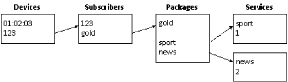

The following diagram shows the series of searches required to find out the channels being served to a particular device:
A view includes phases, and the result from each phase can be used in the next phase
You can define a view so that a search for a device's MAC address can return the channels available on the device.
The following diagram shows the results of such a search:
Example view, showing the results from each phase being used as inputs for the next phase
