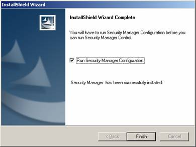

    After the installation process has been completed, the following screen will appear:
    Screenshot of the final page of the Entrust installation wizard
  2. Select the Run Security Manager Configuration checkbox.
  3. Click Finish.

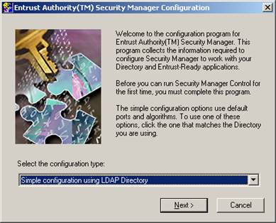

    The Security Manager configuration wizard begins
  4. Select the Simple Configuration using LDAP Directory from the dropdown list, and click Next.

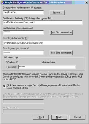

  5. Follow the standard installation process until the Simple Configuration for LDAP Directory dialog appears:
    Screenshot of the Simple Configuration using LDAP Directory page in the of the Entrust cinfiguration wizard
  6. Add the Root CA certificate DN credentials, and click Test Bind Information to test these credentials.
  7. Add the bind credentials of the administrative user, and click Test Bind Information to test these credentials.
  8. Add the DSA connection information of the Entrust DSA that you created in Create an Entrust DSA.
    The details should be entered as is displayed above. The only change may be in the DN structure, if you've created a different DN suffix to the “o=entrust,c=au” suffix used above.
    Note: You cannot use this dialog to change the TCP/IP port to connect to the DSA. This is set to port 389, which is the reason that you must set the Entrust DSA to use port 389.
