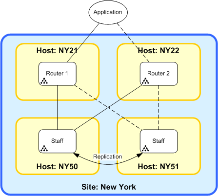

Example: Client Fails Over to Second Router
The following diagram shows a simple directory system with two kinds of failover.
As in Failover Between Hosts, the router DSAs can fail over to the second data DSA. However, this system also shows that the client application can fail over between the two router DSAs.
These two router DSAs are set up to use the data DSAs in exactly the same way, which means that the service to the client application is not interrupted.
Simple example showing that the client application can use the second router DSA if the first one fails
