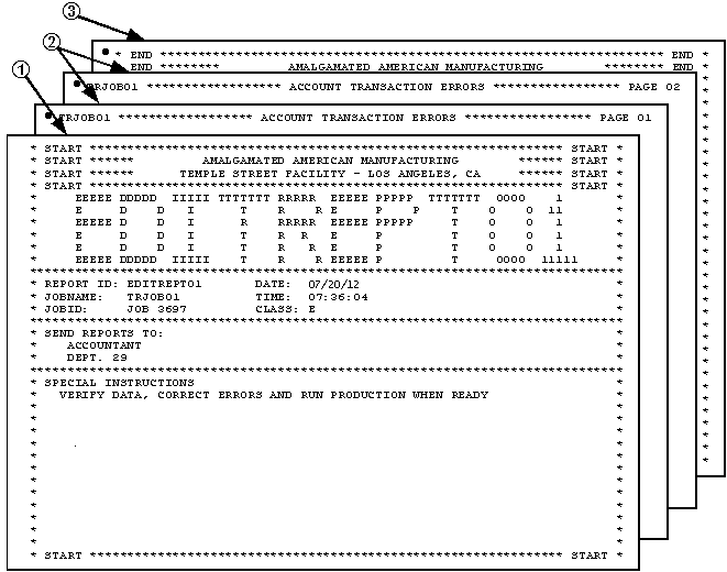

A basic report consists of an entire SYSOUT data set. This data set is distributed as a unit.
Note: A single banner page that contains report and distribution information is attached to both the beginning and end of a basic report.
This illustration shows a basic report:
Contains the following information:
These numbers indicate the date and time when the SYSOUT data was created and the SYSOUT class to which the reports are written.
You provide this information in the contents of the distribution identifier that indicates the report recipient .
Note: The report recipient is either the person who receives the report, or the location where the report is to be distributed.
These instructions provide details about the report or tell recipients what to do with the report.
Note: The banner pages in this guide are slightly different than the model banner pages that are distributed with the product. You can modify the banner pages to suit your needs.
Contains SYSOUT records—which an application program writes—that compose a report
Contains the same information as the start banner page
