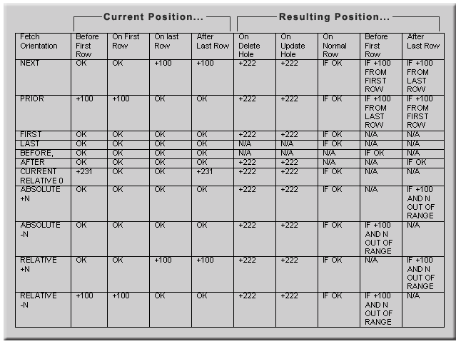

Starting and Resulting Cursor Position
Kalpana Shyam of IBM Silicon Valley Lab provided the table below in her presentation "Scrollable Cursors: Fetching Opportunities for DB2 for OS/390" at the DB2 and Business Intelligence Technical Conference, October 16-20, 2000.
Starting and resulting cursor position
scrollcursorchart
Note: If a fetch encounters an update or delete hole, a +222 SQLCODE is returned to the program.
