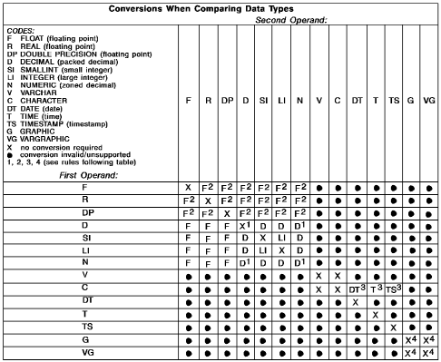

The following table lists the conversions that must take place before two numbers can be compared.
To determine the data type used in the comparison operation, locate the data type of the first operand in the left column. Next, locate the data type of the second operand in the vertical columns to the right.
The data type specified at the intersection of the two columns is the data type used in the actual comparison operation. In some cases, this data type is different from that of both operands, indicating that both operands are converted before the comparison is made.

In the previous tables, the following numbered rules are referenced:
For decimal numbers, the comparison is done in DECIMAL form. The number with the smallest scale is extended with zeros to match the scale of the other number before the comparison.
Any number compared to a floating-point number must be converted to FLOAT. Two floating-point numbers are equal only if the bit configurations of their normalized form are identical.
