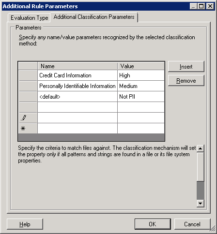

  3. Click the Classification tab and then click the Advanced button.
    The Additional Rule Parameters dialog appears.
  4. Click the Additional Classification Parameters tab.
    The Parameters section lists the name-value parameters that the classification mechanism recognizes.
    The Name column lists the classifications returned by the current classification mechanism. For this rule, the classification mechanism is the CCS FCI plug-in.
    The Value column lists values for the built-in FCI property.
  5. Enter a CCS classification in the first row of the Name column.
    For example, enter 'Credit Card Information'. The next section, 'Mapping Guidelines', explains how this example mapping works.
    Important! Enter the CCS classification name exactly as it is returned by the CCS. The full list is available in CCS Classifications.
  6. Enter the corresponding value in the first row of the Value column. The FSRM 'Personally Identifiable Information' classification property that you created previously has values of High, Moderate, and Not PII.
    For example, enter 'High'.
    Now, when the CCS classifies a file as containing credit card numbers, FCI sets the file's classification property to 'Personally Identifiable Information: High'.
  7. Repeat steps 5 and 6 to specify the remaining name-value parameters.
    A '<default>' entry in the Name column equates to 'any CCS classification not listed elsewhere'. Enter '<default>' and 'Not PII' in the Name and Value columns respectively in the bottom row of the table.
    Note: See the 'Mapping Guidelines' section for further information.
  8. Click OK to close the Additional Rule Parameters dialog.
  9. Click OK to close the Classification Rules Definition dialog.
