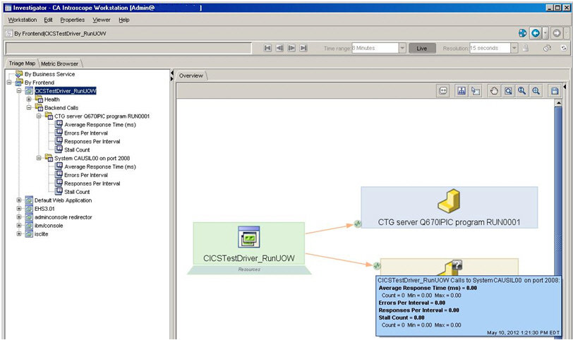

The screen capture shows the metric icons on a Triage Map.
The circular green icons (at which the arrows point) indicate that metrics exist. These metric icons can be used to access blame point metrics for the call to the method com.ibm.ctg.client.JavaGateway.flow(). These metric icons appear only when the application is up and the agent is connected to the EM. Mouse over the metric icon, and the metrics appear.
