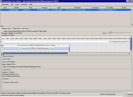

  3. Click OK to view transactions that meet the specified criteria in the Transaction Trace Viewer window:
    This image is the Transaction Trace Viwere window shows a sample transaction with its component details displayed in the lower portion of the window.
    The returned trace is the correlated front-end and back-end trace.
