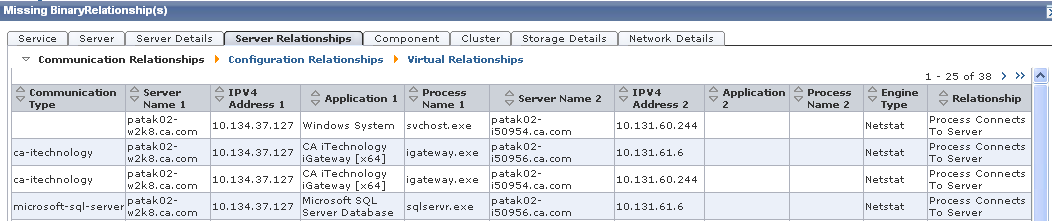

The source information of the CIs is listed failed during the export to CA Catalyst when the job was run as shown in the following illustration:
Note: For more information about the failed CIs and how to resolve the errors, see the CA Configuration Automation Connector Guide.
