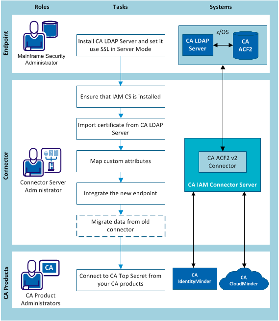

The following diagram shows the tasks that are required to connect to the endpoint, and who does each task.
Diagram showing how to configure ACF2 v2 connector with CA IAM CS to acquire ACF2 endpoint
  1. The mainframe security administrator installs CA LDAP Server on the mainframe, then sets it to use SSL in Server Mode.
  2. The connector server administrator does the following steps:
    1. (If necessary) Install CA IAM Connector Server. For details, search for Install CA IAM CS in the Identity Management bookshelf.
    2. (If necessary) Import the CA LDAP Server certificate into the CA IAM Connector Server keystore.
    3. (If necessary) Map custom attributes.
    4. Integrate the managed endpoints in Identity Management.
    5. For CA CloudMinder, configure the cloud-based CA IAM Connector Server for setting up CA IAM Connector Server on the cloud.
    6. If necessary, the Identity Management administrator migrates data from a CA ACF2 endpoint that used the old plug-in connector. This is described in How to Migrate Data.
  3. The CA product administrators connect to the endpoint in Identity Management or CA CloudMinder.
