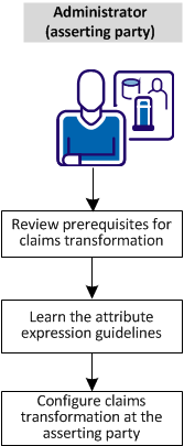

The following figure shows the configuration steps:
Flow of claims transformatio tasks
To set up claims transformation, perform the following steps:
  1. Review the prerequisites for claims transformation.
  2. Learn the attribute expression guidelines.
  3. Configure claims transformation at the asserting party.
