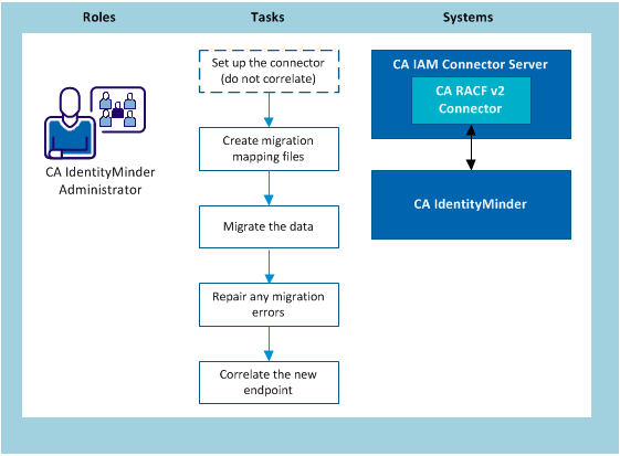

CA IAM Connector Server comes with a tool that helps you migrate account templates and their associations to objects of the new connector. If Identity Management already manages RACF endpoints using the plugin connector, you can use the existing RACF data with the new connector.
This tool migrates the following data:

The migration tool works with two mapping files:

Follow these steps:
When you run the mapping tool, use the –c option to specify the path to the mapping file.
When you run the mapping tool, use the –m option to specify the path to the mapping file.

Before you migrate your data, we recommend that you run a simulation first. This generates an HTML report that lists the following items:
You can then use the same migration tool to run the real migration.
Follow these steps:
cs_home/bin/RACFv2Migrate
RACFv2Migrate -h mycomputer -d im -p 20390 -u admin -c c:\endpointconfig.txt -m c:\schema_map.txt -r S
RACFv2Migrate -h server32 -d im -p 20389 -u etaadmin -n -r R -c tss_endpoints.properties -l logging.properties
The tool migrates the data and saves a report in cs_home/jcs/resources/racfv2.
