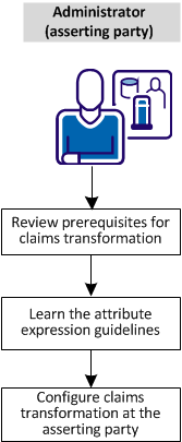

The following figure shows the configuration steps:
To set up claims transformation, perform the following steps:

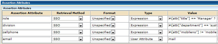

Define expressions in the Assertion Attributes table of the CSP console. Access this table by navigating to the Assertion Configuration step of the partnership wizard. This table is shown in the following figure:
Enter expressions in the Value column of the assertion attributes table. All attributes in an expression are user store or session store attributes.
