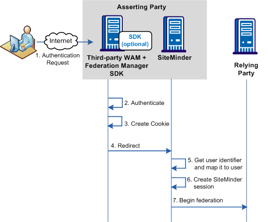

Cookie Method for Passing User Identity
CA SiteMinder® can use an open-format cookie to pass a user identity. The cookie contains a user login ID as one of its values.
Authentication can begin at the WAM system or at CA SiteMinder®. If authentication begins at CA SiteMinder®, it redirects the user to the WAM system. The authentication process is the same as if it began at the WAM system.
The delegated authentication process is as follows:
  1. An authentication request comes into to the third-party WAM system.
  2. The user is authenticated.
  3. The third-party WAM system obtains a cookie in one of two ways:
    Note: The WAM system and CA SiteMinder® must be in the same cookie domain.
  4. The WAM system redirects the browser to CA SiteMinder®.
  5. CA SiteMinder® extracts the login ID from the cookie then locates the user in its user directory.
  6. CA SiteMinder® creates a CA SiteMinder® session.
  7. After the session is created, federated communication with the relying party proceeds.
The following picture shows the cookie method when authentication is initiated at the third-party WAM. CA SiteMinder® is not protecting the WAM application.
Delegated authentication flow using an open format cookie
Important! To use an SDK-created open-format cookie, the third party must install a Federation Manager SDK. The SDK is a separately installed component from CA SiteMinder®. The installation kit contains the documentation that describes how to use the SDK for delegated authentication.

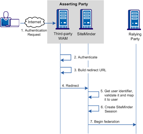

Query String Method for Passing User Identity
A third-party WAM system can pass a user identity to CA SiteMinder® by appending a query string on the redirect URL. For this method to work, the third-party WAM system has to configure a URL that redirects federated users to CA SiteMinder® after they are authenticated.
Important! Do not use the query string method in a production environment. The query string redirection method is only for a testing environment as a proof of concept.
If authentication is initiated at the WAM system, the process for delegated authentication using a query string is as follows:
Note: Authentication can also be initiated at CA SiteMinder® or at the relying party.
  1. The third-party WAM system receives an authentication request.
  3. The third-party WAM system constructs a redirect URL and adds the login ID and hashed login ID values to the query string in the format LoginID=LoginID&LoginIDHash=hashed_LoginID.
    Important! The LoginID and LoginIDHash parameters are case-sensitive. Be sure to include them in the redirect URL as shown in the example.
    The hashing mechanism allows CA SiteMinder® to verify that the user ID has been received unchanged.
    Example of a Redirect URL
    http://idp1.example.com:9090/affwebservices/public/saml2sso?SPID=FmSP&ProtocolBinding=urn:oasis:names:tc:SAML:2.0:bindings:HTTP-POST&LoginID=jdoe&LoginIDHash=454d3bd5cb839168eeffcf060ae0b9c28ed6eec0
  5. CA SiteMinder® extracts the login ID and hashed login ID from the URL, validates the identifier using the hashed value, and locates the user in its user directory.
  6. CA SiteMinder® creates a user session.
The following picture shows the query string method when authentication is initiated at the asserting party.
Delegated authentication flow using a query string
