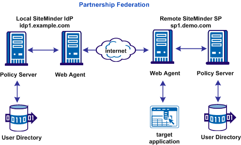

Sample Federation Network
The initial partnership that you are creating represents the following sample network. The URLs in the procedures and sample network are examples and do not resolve to any real site.

The following figure shows the sample partnership with CA SiteMinder® at both partners.
This diagram shows a Sample SAML 2.0 Partnership Federation Network
