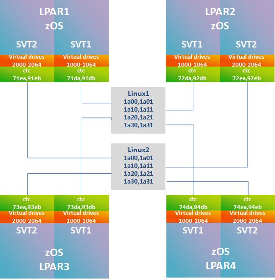

The following is a diagram of two z/OS LPARs communicating with a single Linux on System z host:
This diagram is an example of a multiple LPAR setup.
