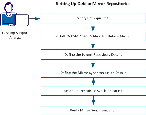

As a desktop support analyst, you can set up mirrors of a Debian repository to help ensure easy access and faster download of the packages at the target computers. The following diagram illustrates the steps that you perform to set up Debian mirror repositories:
Setting Up Debian Mirror Repositories
Perform the following tasks to set up Debian mirror repositories:
  1. Verify Prerequisites
  2. Install CA DSM Agent Add-on for Debian Mirror
  3. Define the Parent Repository Details
  4. Define the Mirror Synchronization Details
  5. Schedule the Mirror Synchronization
  6. Verify Mirror Synchronization
