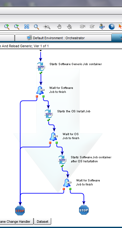

  10. Link the success result to the next valid operator in the process definition and the failure result to abnormal exit as shown in the following screenshot:
    Screenshot showing CA IT PAM process definition with the software generic job container
    The wait operator is configured.
