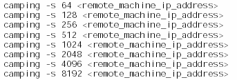

If you have determined that the product components are properly running and active, and have ensured that two-way communication is possible, use the camping command to determine if this communication problem is due to the level of network protocol support in the environment.
Always try to use User Datagram Protocol (UDP) as the preferred/default connection protocol. The only exceptions to this rule are when it is determined that one of the following has occurred:
For example:
If you determine that there is a size restriction, specify smaller increments to try to establish the exact maximum size that can be supported.

In this example, len 8198 in the second line refers to the size of the message packet that CAM is trying to send (in this case 8198 bytes). You can then establish the largest packet size that CAM has by looking for this field in all the messages that have been sent by CAM. If this exceeds the size of the maximum UDP packet (as determined in the previous step through the use of the camping -s switch), consider increasing or removing the UDP packet size restriction.
