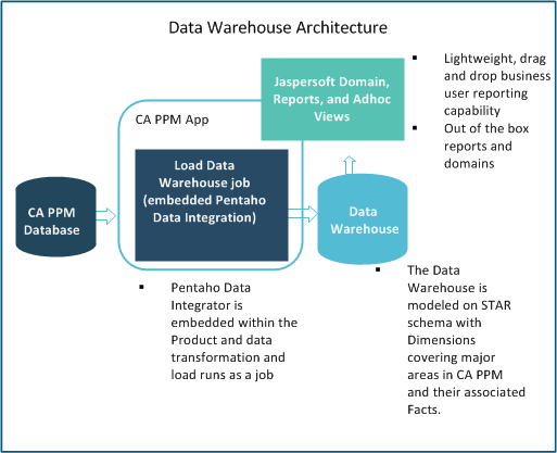

The Data Warehouse provides a schema that is optimized specifically for analytics. A set of CA Clarity PPM jobs extract, transform, and load the data from CA Clarity PPM to the Data Warehouse. The advantages of the Data Warehouse include:
The following diagram shows the flow of data from the CA Clarity PPM database to the Data Warehouse.
The Data Warehouse addresses several data and reporting challenges that users experienced when working directly with the CA Clarity PPM transactional database.

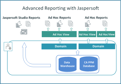

Advanced Reporting uses the Jaspersoft Studio application to manage views, reports, and dashboards. This third-party reporting option is integrated with CA Clarity PPM to provide easy reporting for users. Each report can be customized by selecting the domains and fields needed.
The Jaspersoft domains are a business representation of the Data Warehouse that lets you interact with data without having to understand database complexities. The Jaspersoft domains parallel and serve the same general purpose as the Business Objects Universes. The following figure shows how the Jaspersoft domains can be used to create reports in CA Clarity PPM.
