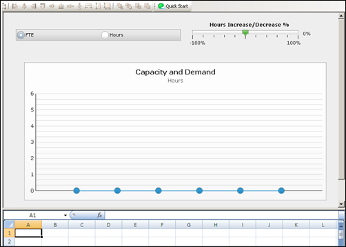

  1. In Xcelsius, Samantha designs a visualization that includes:
    The following figure illustrates the model for her visualization:
    Figure shows Xcelsius visualization.
  2. Samantha then maps the components in the visualization to the appropriate fields in CA Clarity PPM using the embedded Excel spreadsheet.

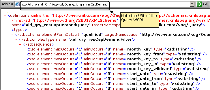

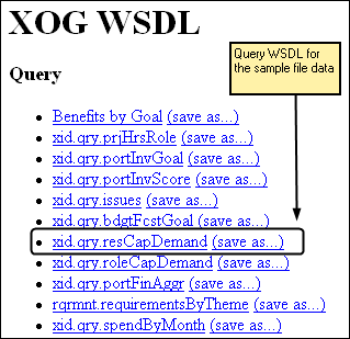

  4. Samantha navigates to the CA Clarity PPM Web Services using the following URL and views the web query WDSL:
    http://<servername:port>/niku/wsdl/Query
    A list of queries appears in XOG WSDL.
    Illustrates the XOG WSDL for a query.
  5. Samantha locates Query and selects the xid_qry_resCapDemand query.
    The WDSL for the query appears.
    Ilustrates the WDSL for the Query and points to the WDSL URL.
  6. Samantha makes note of the query URL (also known as the WDSL URL).

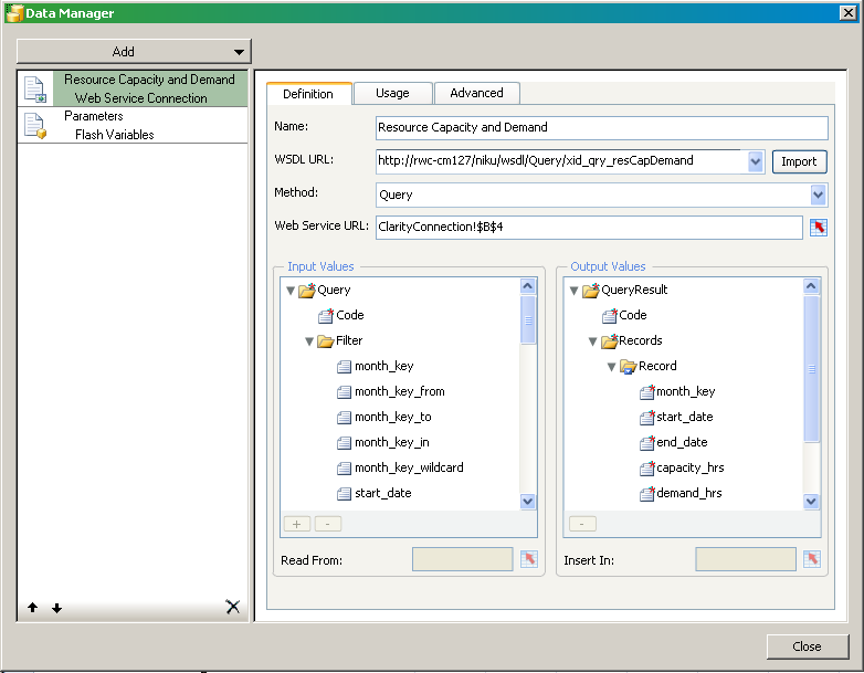

  1. In Xcelsius, Samantha opens the Data Manager and sets up the web service to establish the data connection with CA Clarity PPM.
    The following figure illustrates the completed external data settings:
    Illustrates the set up for a Web Service Connection
  2. Samantha does the following:
    1. Adds a new Web Service Connection definition and names it: Resource Capacity and Demand.
    2. Enters the following WSDL URL and imports it:
      http://forward_Cl/niku/wsdl/Query/xid_qry_resCapDemand
      where forward_cl is replaced with your actual WSDL URL
    3. Selects the Method: Query.
      The method selected changes the attributes that appear in the Data Manager.
    4. Leaves the Data Manager open.

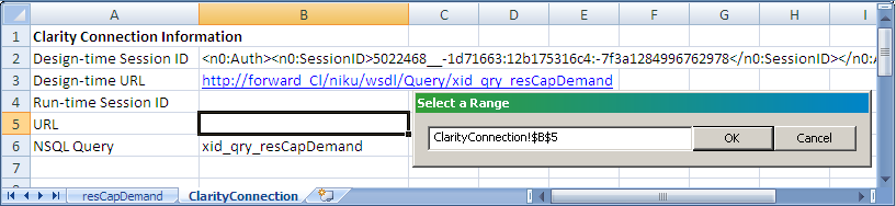

  4. In the ClarityConnection worksheet, Samantha does the following:
    1. Creates labels in the following cells, but does not enter a value in the corresponding B column:
      • cell A1: Clarity Connection Information
      • cell A2: Design-time Session ID
      • cell A3: Design-time URL
      • cell A4: Run-time Session ID
      • cell A5 URL
      • cell A6: NSQL Query
    2. In the Data Manager, Samantha clicks the Cell Selector to the right of the Web Service URL field.
      The Select a Range window appears.
      Illustrates the method for binding a cell to the WDSL Web URL
    3. Selects cell B5 and clicks OK.
      This cell range is added to the Web Service URL field. In a later step, Samantha creates a Flash variable (for example, pSessionID). She also creates a global parameter with the same name in the interactive portlet. At runtime, these combined settings allow the Web Service URL to pass a value from CA Clarity PPM using the Global parameter to the Flash variable. The Flash variable saves the value to the linked cell.
    4. Leaves cell B4 for the run-time session ID empty.
      In a later step, she links the SOAP header to the session ID.
  5. Using the same cell linking technique used for the Web Services URL, Samantha does the following:
    1. In Data Manager, links Code (from the Input Values section) to cell B6 of the ClarityConnection worksheet.
      This action links the query to the visualization.
    2. In the ClarityConnection worksheet cell B6, enters the name of the following query:
      The value of this cell is manually entered because once a query is created, it is absolute.
    3. In the ClarityConnection worksheet cell B2, enters an active CA Clarity PPM session ID in the following SOAP format:
      <n0:Auth><n0:SessionID>0000</n0:SessionID></n0:Auth>
      where 0000 is her current Clarity Session ID.
      Note: To get your current session ID, go to the About page in CA Clarity PPM, and copy and paste the session ID.
      This information will enable you to test the real-time CA Clarity PPM data connection from Xcelsius.
    4. In the ClarityConnection worksheet cell B3, enters the Web Service URL.
      This link is used at design-time to preview and test the connection from Xcelsius.
      The one remaining cell to define is the Run-time session ID. This cell is addressed in a later step when creating Flash variables.

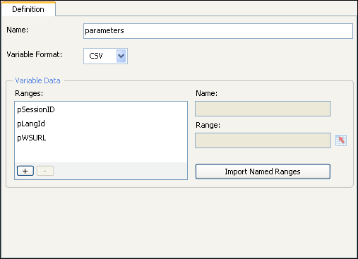

Samantha is ready to create the Flash variables that map to the global and object parameters in the interactive portlet.
  1. In the Data Manager, Samantha adds a new Flash Variable definition and names it parameters.
  2. Samantha selects CSV as the Variable Format.
  3. Samantha creates the required session ID Flash variable and does the following:
    This named Flash variable is mapped to the interactive portlet as the Clarity Session ID in SOAP Header global parameter.
  4. Samantha creates the option Web Service URL Flash variable and does the following:
    This named Flash variable is mapped to the interactive portlet as the Clarity Web Service URL global parameter.
    Shows the flash variables in the example.
Note: The Flash variable (pLangID) shown in the preceding figure is present in the sample design file but is not covered in this example. The Flash variable has a corresponding global parameter in the sample design file which is also called pLangID. This corresponding global parameter is designed to manage languages. For information about handling this parameter, see the Xcelsius product documentation. You can see one implementation of the parameter by viewing the downloaded sample file in Xcelsius.

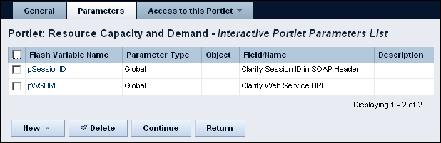

  3. In CA Clarity PPM, Samantha creates the Resource Capacity and Demand interactive portlet using Studio and imports the capDemand.swf file.
  4. Samantha defines the following global parameters for the new interactive portlet with the same names as the Flash variables created in Xcelsius:
    The figure shows the global parameters.

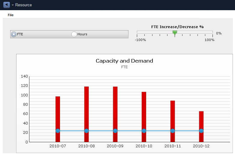

  6. Samantha opens the Resource dashboard and looks at the data in the new interactive portlet.
  7. Samantha sends William a message that he can open the Resource dashboard and see the data he requested.

William logs in to CA Clarity PPM and goes to the Resource dashboard. William sees the interactive portlet displaying visual information. Bars on the graph show the FTE developer role demand by month. The blue horizontal line shows the capacity for that role. The FTE percent increase/decrease is currently set at zero percent.
Illustrates the Demand Capacity bar chart.
Based on the information displayed in the Capacity and Demand graph, William can see that the role demand per month exceeds the role capacity. Using the gauge, William performs a what-if scenario by increasing the FTE percent to see if resolves the staffing issue. Based on the analysis, William contacts the project manager and recommends hiring five developers and reassigning five developers from nonstrategic projects.
