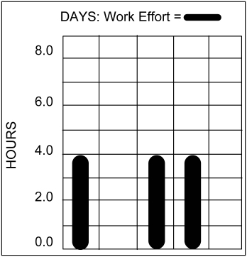

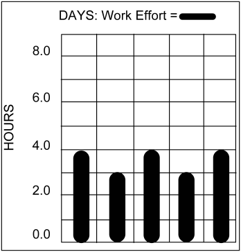

Uniform Loading Pattern
The Uniform loading pattern assigns resource time evenly across a task only on those days when the resource is available to meet the task requirements. For example, if a resource is scheduled to work four hours per day on a task, the resource will not be scheduled to work on that task on days when the resource is only available to work on the task for three hours. The maximum percentage and resource availability is taken into account when assigning resources to tasks using this loading pattern.
Note: To use this loading pattern, you must set the resource's maximum percentage on the task.
Graphically, this loading pattern can look like this:

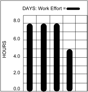

Front Loading Pattern
The Front loading pattern allocates resource usage as early in the task as possible. Resources are assigned to get work done as early as their availability permits. The resource's maximum percentage on a task and resource availability are taken into account when assigning resources to tasks using this loading pattern.

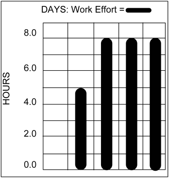

Back Loading Pattern
The Back loading pattern allocates resource usage as late as possible in the task. Resources are assigned to get work done as late as their availability permits. The Max % and resource availability is taken into account when assigning resources to tasks using this loading pattern.

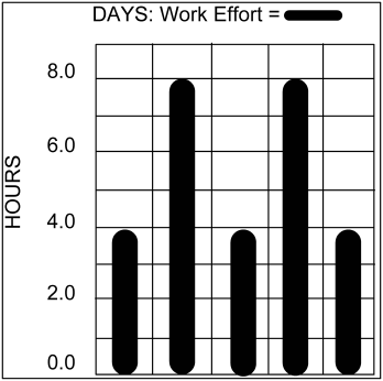

Contour Loading Pattern
The Contour loading pattern fits resource loading around the resource's remaining availability, smoothing out the peaks and valleys. It is a very flexible loading pattern; it can appear as the reverse or mirror image of overlapping task patterns.
If a task's duration, start date, or finish date changes, or if you autoschedule the task or enter new ETC values, this pattern assumes the characteristics of the Uniform loading pattern. The changes you make to the duration of a task after it is scheduled causes resource assignments for each period to even out across the duration of the task.
