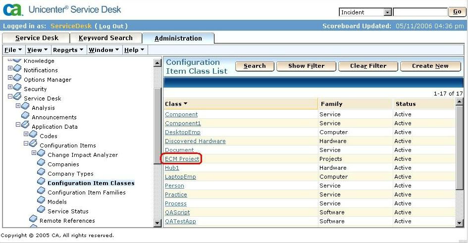

  3. Select Administration, Service Desk, Configuration Items, and Configuration Item Classes from the Administration tab.
    Note: If you chose ITIL, the list displays CIs and CI classes. If not, the list displays assets and asset classes.
    The Configuration Item Class List appears in the right pane, as follows:
    A class named ECM Project appears in the list. This class is a member of the CI family of the project. You can use this class to create the project CIs for the connector.

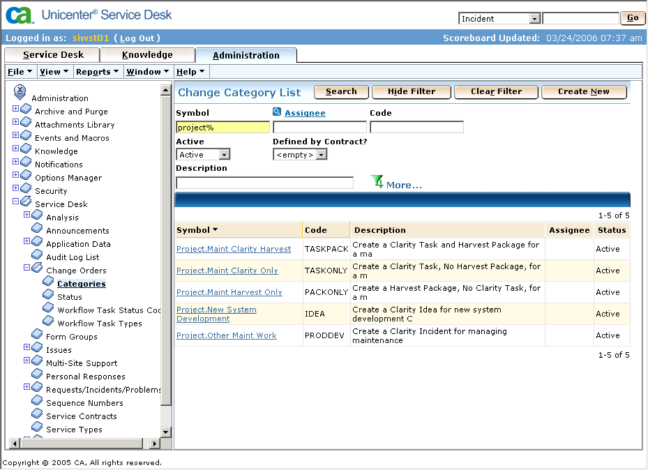

  12. Select Service Desk, Change Orders, and Categories from the Administration tab.
    The Change Category List appears in the right pane. These sample change categories define the workflow tasks, Valid Task Statuses, and Action Macros associations needed for the various types of Change scenarios that can be performed with the connection.
  13. Enter project% in the Symbol field, and click Search to perform a search for all change categories that begin with project.
  14. Verify that the following change categories are listed, as follows:
  15. Using the following table, access the detail window for each category and verify the Change Category, Workflow Task, Valid Status, and Status = Action Macro:
