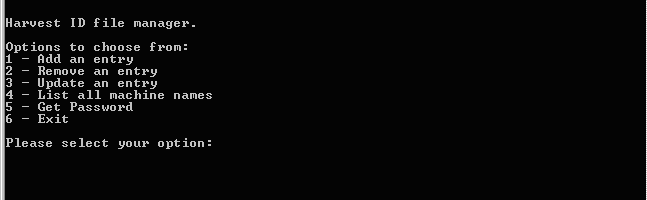

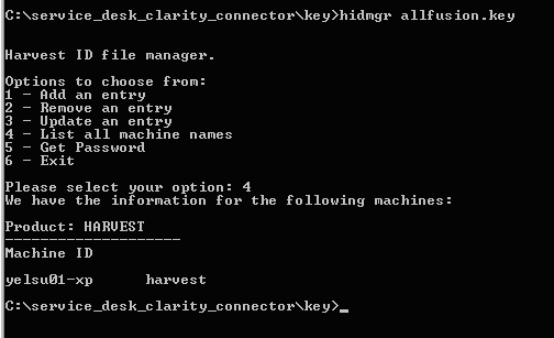

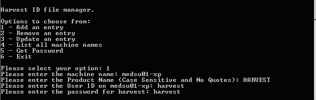

Use the hidmgr to add, read, modify, and delete entries in the connector's key file. After you create this key file, add the required entries for Harvest and Service Desk to the file, once for Harvest and once for Service Desk.

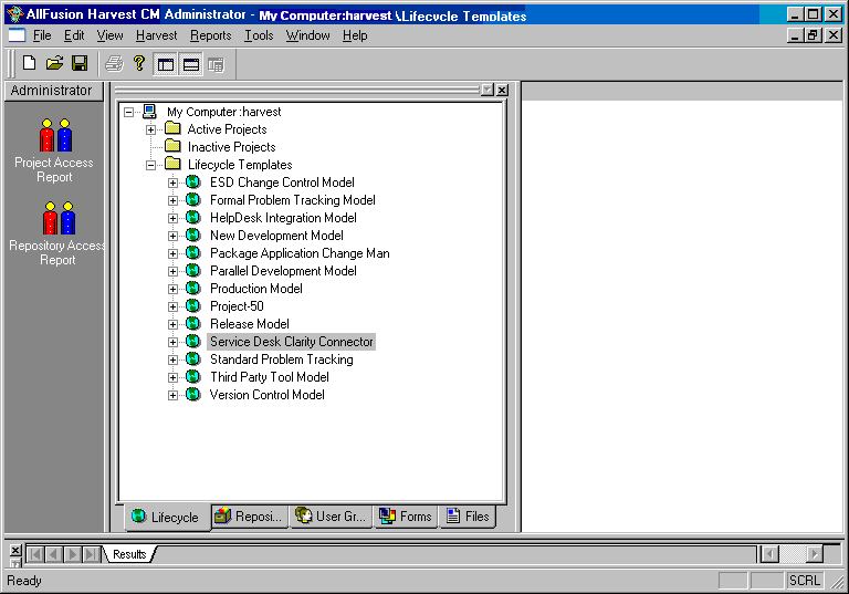

Create a Harvest project using the Service Desk Clarity Connector lifecycle template. This project template provides the necessary forms and processes to integrate Harvest with Service Desk and CA Clarity PPM.
Load the SD-Clarity Connector form into the Harvest database and verify that it appears in the list of available forms in the Harvest Administrator application.
To use the Service Desk Clarity Connector lifecycle template and the Service Desk Clarity Connector Request for Change form, Harvest CM Workbench users must copy the following files to the Harvest Forms folder on their local computer:

Use the hidmgr to add, read, modify, and delete entries in the connector's key file. After creating this key file, add the required entries for Harvest and Service Desk to the file, by following these steps, once for Harvest and once for Service Desk.
Important! Perform this step on the Harvest‑UNIX server only.

Use the hidmgr to add, read, modify, and delete entries in the connector's key file. On both the Harvest and Service Desk servers, after creating this key file, add the required entries for Harvest and Service Desk to the file, once for Harvest and once for Service Desk.
Important! Perform this step on the Harvest-Windows server only.

Create the Harvest project using the Service Desk Clarity Connector lifecycle template. This project template provides the necessary forms and processes to integrate Harvest with Service Desk and CA Clarity PPM. You can do this from your Harvest server or from the Harvest client application.
To create the Harvest project from the Service Desk Clarity Connector lifecycle template on a Harvest client/server
himpenv -b [broker name] -usr [harvest user name] -pw [harvest password] -f sd_cl_connector.har -oa test.log -wts
Example:
himpenv -b hqatest5-2003 -usr harvest -pw harvest -f sd_cl_connector.har -oa test.log -wts
To create the Harvest project from the Service Desk Clarity Connector lifecycle template on a Harvest client application
The Harvest Administrator application GUI appears.
All lifecycle templates display as follows:
The Copy Project dialog appears.
On the Copy Project dialog, ensure that:
The new project appears in Active Project list.

Use the Harvest ID File Manager utility (hidmgr) to add, read, modify, and delete the connector's key file entries. After creating this key file, add the required entries for Harvest and Service Desk to it.
Note: Instructions for running the hidmgr appear in context. This section provides additional details about the utility for your information.
When prompted, enter values for the following:
Important! For Service Desk, specify the computer name in URL format: http://<computer name>:< port>; for example, http://computer55:8080.
The hidmgr utility provides the following options to maintain the connector's key file:
When you select Options 1 to 5, the utility prompts you to enter required information.
When you start the hidmgr, the following screen appears:
If you select Option 1, hidmgr prompts you to supply the information shown on the following sample screen:
After you answer the prompts shown, the information that you entered is added to the key file.
To view the product information, select Option 4, as shown on the following screen:
