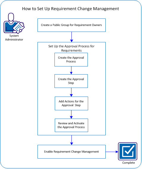

The following diagram describes how a system administrator can set up Requirement Change Management.
To set up RCM, perform these steps:
- Create a public group of requirement owners.
- Set up the approval process for requirements.
- Enable Requirement Change Management.
Set Up the Approval Process for Requirements
In RCM, the requirement owners follow a process to get their requirement requests approved. The process defines what happens when requirement owners submit requirements. For example, set up an approval process in Salesforce.com containing one defined step with two actions, to approve or reject the requirement.
To set up the approval process, perform these steps:
- Create the Approval Process.
- Create the Approval Step.
- Add Actions for the Approval Step.
- Review and Activate the Approval Process.
