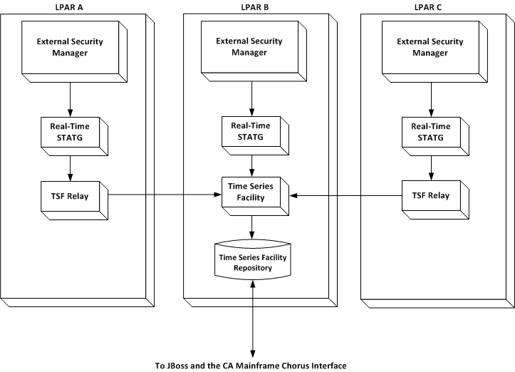

The following diagram shows a real-time statistical gathering (STATG) configuration for a single enterprise:
Your external security manager uses the following process to provide real-time statistical data to TSF:
Note the following:
For more information about TSF, see the CA Chorus Installation Guide.
