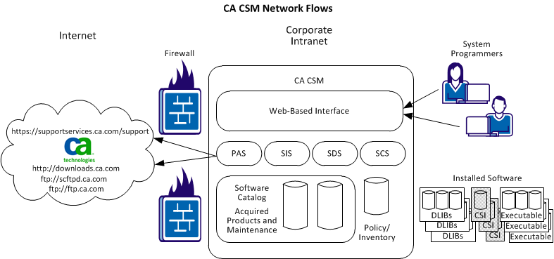

Network Flows
CA CSM uses the following process to connect you directly to the appropriate CA Technologies website, where they can manage your CA Technologies software:
  1. You connect to CA CSM from within your corporate Intranet (locally connected or tunneled in through VPN) using the HTTP protocol such as http://yourmainframe:yourport/CSM).
  2. The CA CSM Product Acquisition Service communicates with CA Technologies using the same methods that you previously used when manually accessing the website, as follows:
    HTTPS
    Passes credentials to, and obtains product information from the appropriate CA Technologies website.
    FTP
    Downloads software packages from CA FTP Services to your mainframe system using an anonymous FTP, with no credentials passed. CA CSM accesses one of the following locations:
Note: The following information is the only unencrypted data sent to and from CA Technologies:
None of this data is part of any privacy or encryption standards.
This process is depicted in the following illustration:
The illustration shows the relationship between CA CSM components.
