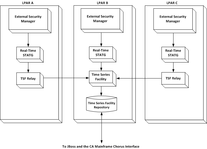

The following diagram shows a real-time statistical gathering (STATG) configuration for a single enterprise:
This diagram shows a sample Time Series Facility configuration whereby three LPARs with three separate External Security Managers feed data to one Time Series Facility repository, which then is sent to JBoss.
Your external security manager uses the following process to provide real-time statistical data to TSF:
