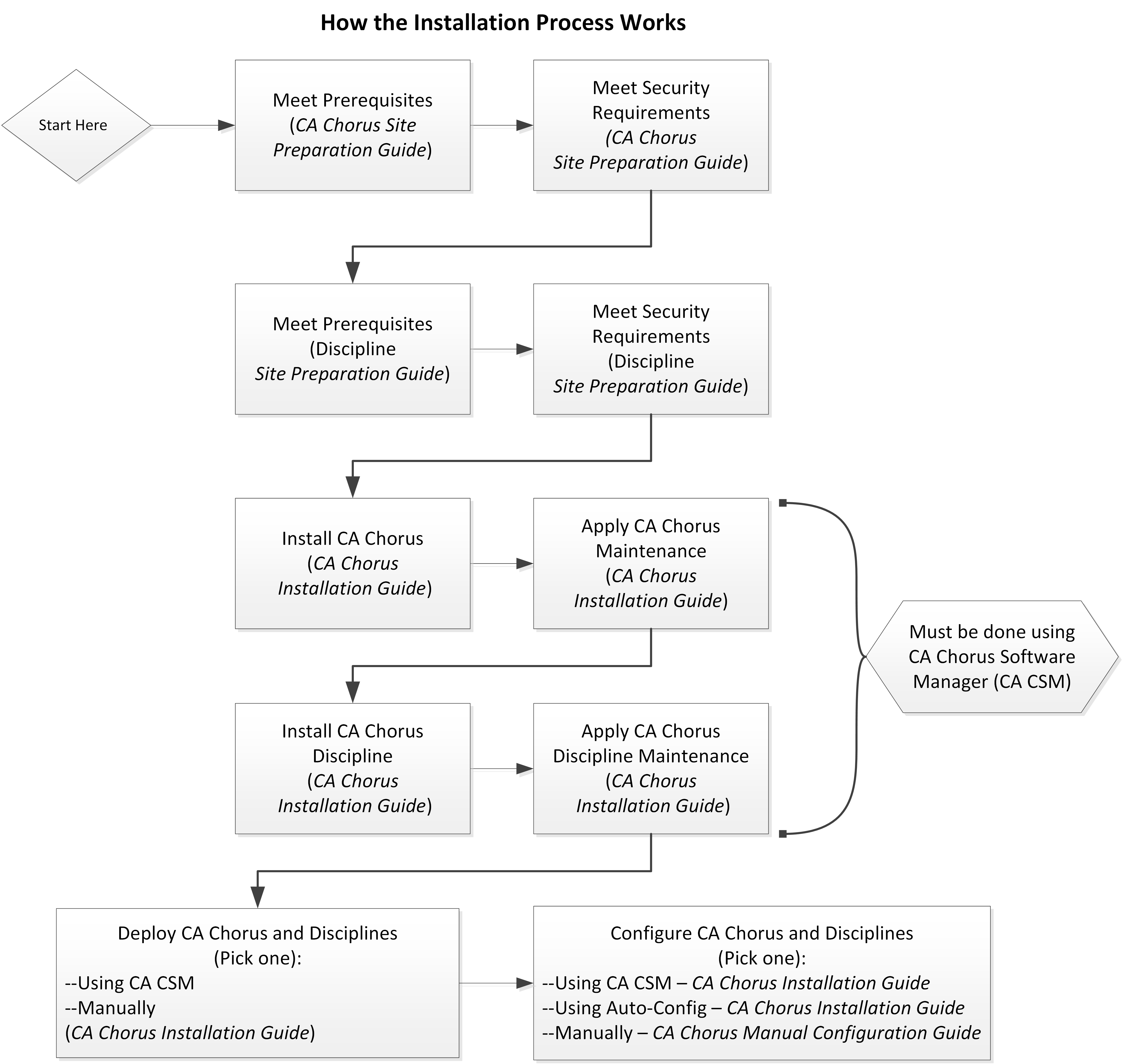

How the Installation Process Works
This guide details the tasks that a system programmer and security administrator can complete before starting the installation, deployment, and configuration tasks that are described in the Installation Guide. The following diagram provides a high-level overview of the CA Chorus and discipline installation, deployment, and configuration process and the guides that you use.
Important! You must use CA Chorus Software Manager to install CA Chorus and its disciplines.
Important! If you install a discipline, you must deploy and configure it.
Note: For the boxes that indicate work from the discipline Site Preparation Guide, repeat this step for each discipline that you are installing.
This illustration shows the process for installing, deploying, and configuring CA Chrous and your disciplines.
To install, deploy, and configure your CA Chorus and its disciplines, complete the following steps:
  1. Meet the software, system, port, and other prerequisites as described in the CA Chorus Site Preparation Guide.
  2. Meet the security requirements as described in the CA Chorus Site Preparation Guide.
  3. Use the Prerequisite Validator to confirm that you have set up your system correctly as described in the CA Chorus Site Preparation Guide.
  4. Meet the software, system, port, and other prerequisites as described in the applicable discipline Site Preparation Guide. Repeat this step for each discipline that you are installing.
  5. Meet the security requirements as described in the applicable discipline Site Preparation Guide. Repeat this step for each discipline that you are installing.
  6. Install CA Chorus and the applicable disciplines using CA CSM as described in the CA Chorus Installation Guide. This step involves acquiring the CA Chorus software (transporting to your z/OS system) and installing using SMP/E. The installation process creates a CSI environment and runs the RECEIVE, APPLY, and ACCEPT SMP/E steps. The software is untailored.
  7. Deploy CA Chorus and the applicable disciplines using CA CSM or a manual process. The CA Chorus Installation Guide details both methods.
    This step copies the target libraries to another system or LPAR.
    Important! For deployments from CA CSM, you must deploy CA Chorus and your disciplines at the same time. For example, installing CA Chorus, DBA, and Security, and then deploying only CA Chorus and DBA is not supported.
    Important! To use the CA CSM Software Configuration Service, CA CSM deployment is required.
  8. Configure CA Chorus and the disciplines. This step creates customized load modules, bringing the CA Chorus software to an executable state. You configure the product using one of the following methods:
    Note: We recommend one of the first two options as the most efficient method to configure your products.
    CA CSM
    This method lets you use the wizard-based CA CSM tools to configure the product. For this configuration method, a deployment using CA CSM is required.
    The Installation Guide includes the CA Chorus and discipline steps for this method.
    Automated Configuration
    This method lets you edit one batch job (ETJICUST) and one configuration file. A Java program then propagates your changes to the applicable members. You then manually submit each job. For this option, we recommend that you configure the platform and disciplines at the same time.
    Manual
    This method lets you manually edit and run each configuration job.
    For this method, configure CA Chorus and its disciplines using the Manual Configuration Guide.
    Your CA Chorus system is installed, deployed, and configured.

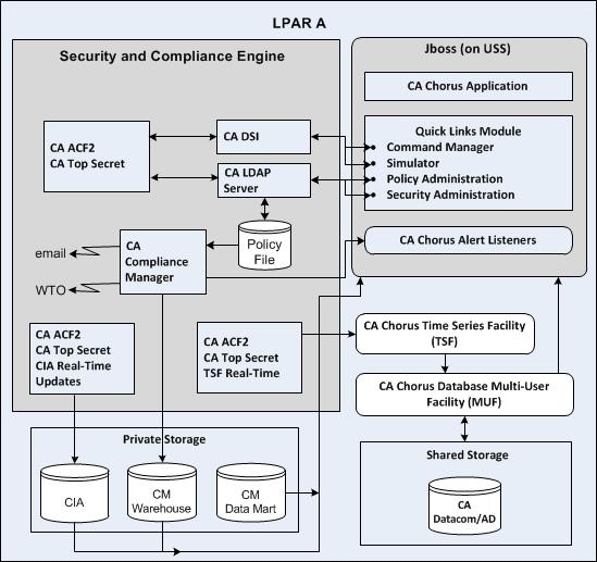

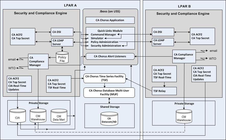

Architecture and Setup Overview
The following diagrams provide an overview of the CA Chorus for Security and Compliance Management discipline architecture. After installation and setup, use it to manage security resources across your z/OS enterprise.
Observe the following:
To install and configure this discipline you must:
The diagrams illustrate the basic architecture:
LPARs
Identify logical partitions of a mainframe (z/OS system), on which you execute your External Security Manager (ESM) as a back-end engine for this discipline. Multiple LPARs are supported.
CA Chorus Application Server
Contains the CA Chorus system. Includes the following components:
Provides the browser support and components to communicate with the back-end engines for the various disciplines, such as the security engine.
Quick Links Module
For this discipline this module includes the Administer Compliance Policy, Administer Security Definitions, and Simulate Access Attempt interfaces.
Security Command Manager Module
Issues native commands to backend security engines from the CA Chorus interface.
CA Chorus Listeners
Provides the service for receiving Alerts sent by the various backend security engines.
CA Chorus Time Series Facility (TSF)
Provides the facility for receiving, storing, and querying metrics about objects managed by the security backend engines. Because all metrics are date- and time-stamped, a series can be graphed over time to show trends, and to project into the future.
CA Chorus Database Multi-User Facility (MUF)
Provides the infrastructure for storing and retrieving TSF.
Security Engines
Composite of the ESM and compliance products that together provide the input to this discipline. Includes but is not limited to CA ACF2, CA Top Secret, CA Compliance Manager, and CA LDAP Server.
Shared Storage
Represents all storage devices that are shared across the CA Chorus disciplines.
Private Storage
Represents storage devices that are shared only across this discipline.
