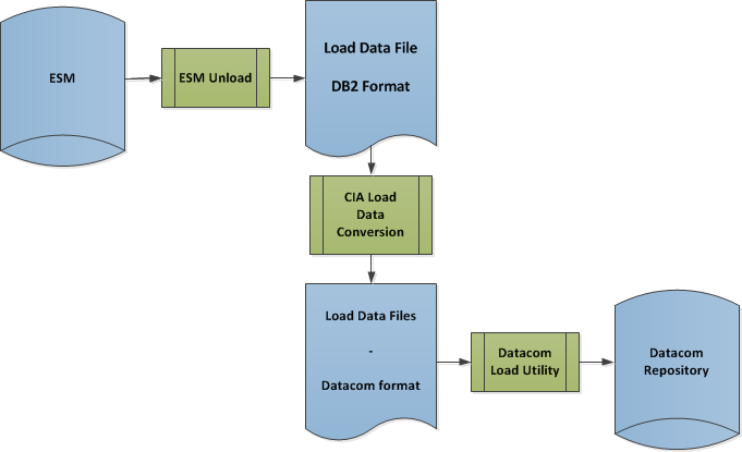

The CIAUNLD job executes the unload utility, which reads the security information from the security database and creates an unload data set.
The unload data set is used as input to the CIALOADC job. Since the unload data set is in DB2 load format, the CIALOADC job converts the user and security policy information in the unload data set from DB2 load format to CA Datacom/AD load format and separates the converted records into individual data sets by table as required by the CA Datacom/AD load process.
The following illustrates the unload/load process for CA Datacom/AD.
Flow of Datacom Unload Process - ESM unload, convert DB2 format to Datacom format - load datacom to repository with Datacom load utility
