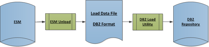

The CIAUNLD job executes the unload utility, which reads the security information from the security database and creates an unload data set. This unload data set is used as input to the DB2 load process which loads the data into a DB2 repository.
The following illustrates the unload/load process for DB2.
Flow of Datacom Unload Process - ESM unload to load data file in DB2 format. DB2 load utility then loads to the DB2 repository.
