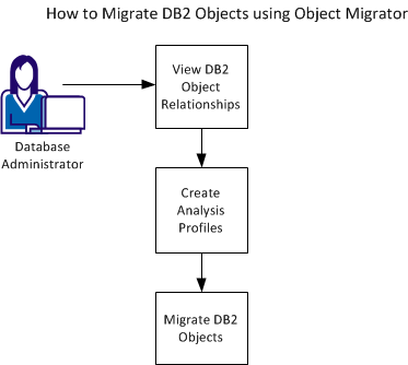

The following illustration shows how a DBA migrates DB2 objects:
To migrate DB2 objects using Object Migrator, complete the following tasks:
