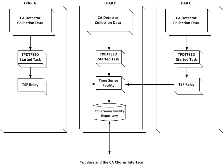

The following diagram shows the statistics gathering configuration for a single enterprise:
This diagram shows a configuration whereby three LPARs with three separate CA Detector collection areas feed data to the Time Series Facility repository.
In the previous diagram, CA Detector passes collection data automatically from each DB2 subsystem being monitored (LPAR A, B, and C) to TSF when a collection interval ends using the TPDTFEED started task. The TSF relay passes data to TSF from remote LPAR A and C. TSF saves the data in the TSF repository.
