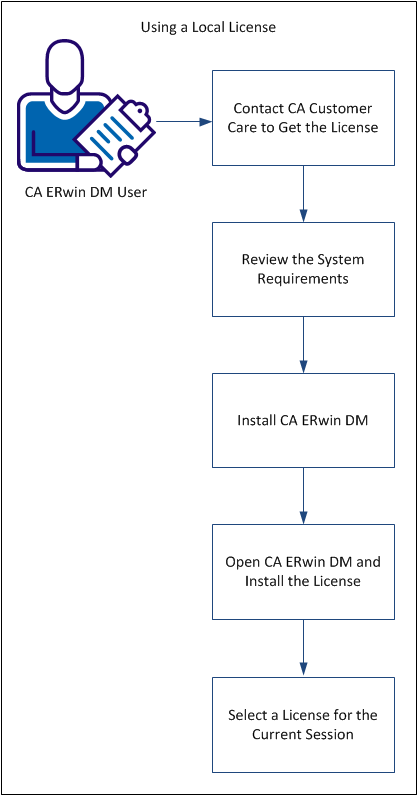

Using a Local License
Use a local license if one of the following requirements applies:
In this licensing model, the license is stored on your local computer.
The following diagram illustrates how to use a local license:
This diagram illustrates  how you can use a local license.
Perform the following tasks to use a local license:
  1. Contact CA Customer Care and get the license.
  2. Review the system requirements.
  3. Install CA ERwin DM.
  4. Open CA ERwin DM and install the license.
  5. Select a license for the current session.
