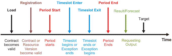

The Engine Events are triggered by the engine according to the associated Contract and Metric definitions. Once the Engine Event is triggered and received, the engine executes the pertinent event handler. Each Engine Event has an implicit event handler. These event handlers are functions and procedures defined on top of the VBScript. The event handler that handles the registration and the “result” function are both mandatory to implement in the code. All other event handlers are optional. However, the Business Logic does not deal with Engine Events for which event handlers are not implemented. Therefore, it is good practice to leave them all in place (even if not being used) to allow for future enhancements.
Note: When writing the Business Logic script it is important to implement all of the Engine events in order to be able to cover all the final possibilities. For example, even if during the first stage of the implementation a timeslot definition was not applicable, but will be in the future, then all the formulas will require amendment. It is therefore recommended for the Business Logic Expert to define the behavior "in timeslot" and "out of timeslot" periods in advance, even if initially it is not applicable, so that when the behavior is introduced, the required system changes are trivial.
Following are various Engine Events and their event handlers:

During each calculation cycle, the Engine evaluates what the relevant Engine Events and Raw Data Events are based upon the calculation time period. It will first sort them by time and then send them to the relevant formulas for calculation. The time of the Raw Data Event is its timestamp and the time of the Engine Event is its triggered time. Both these types of events are then combined in a time sequence, and sent for calculation.
The timings of the Events are according to the associated local Metric, but the Time parameter of the event handlers (ie, OnPeriodStart (Time)) and the timestamp of the Raw Data Event is according to their value in UTC. The Engine compares them according to their values at UTC, so as to use a constant point of reference.
