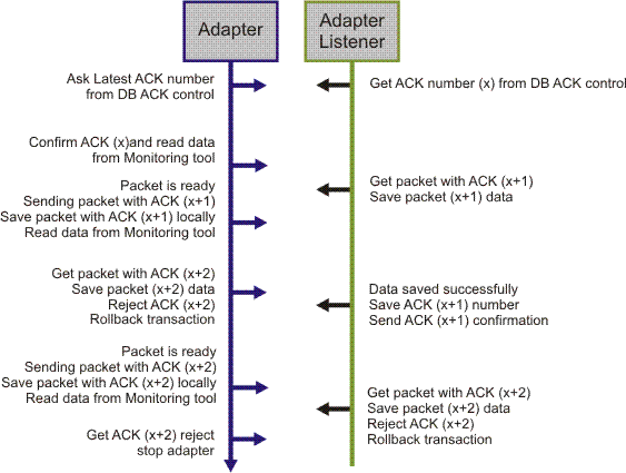

To verify transmission success of data records from the Adapter to the CA Business Service Insight Adapter listener, the Adapter incorporates an ACKs/sliding window algorithm over the TCP/IP layer. This algorithm basically sends the data in packets and then waits for an acknowledgment from the Adapter listener before moving to the next packet. Each packet contains several raw data messages. The number of messages in a packet can be configured by setting the Packet Size parameter. Each packet has a sequence which is contained in the acknowledge message. All relevant parameters that control the process are contained in the CA Business Service Insight interface section of the configuration file. In general however, you do not need to alter these parameters.
The Adapter's Listener writes the raw data in the packet in a single transaction.
Note: The ACK operation can be done only on the raw data messages sent to CA Business Service Insight.
The following figure shows the Adapter communication process.
