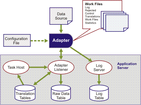

The following entities relate to the Adapter and its configuration and execution parameters.
Data source to which the Adapter connects and from which it retrieves data in its original format.
Output files produced by the Adapter and which are written within the processes (for more details refer to Work Files).
Three message types are transferred between the Adapter and the Adapter Listener:
Adapter can be configured to send log messages to the system log as well as writing them to a local file. If the port and IP address of the log server are specified and set in the registry settings of the Adapter, then the Adapter sends messages to the log server as well.
The following diagram describes the Adapter process in relation to each of the entities with which it interacts.
The following is a description of the Adapter process interaction with these entities:
Contains settings for some or all of the Adapter's configuration parameters. The Adapter uses the configuration file to determine the connection method that is used by the Adapter and the Metrics for parsing in order to create the Event output. This is an XML file, and the format contains six basic elements:

Each of these six sections contains all of the relevant information that allows the Adapter to connect to the data source, retrieve the required information, parse it into CA Business Service Insight unified events structures, and store it within the CA Business Service Insight Raw Data table.
