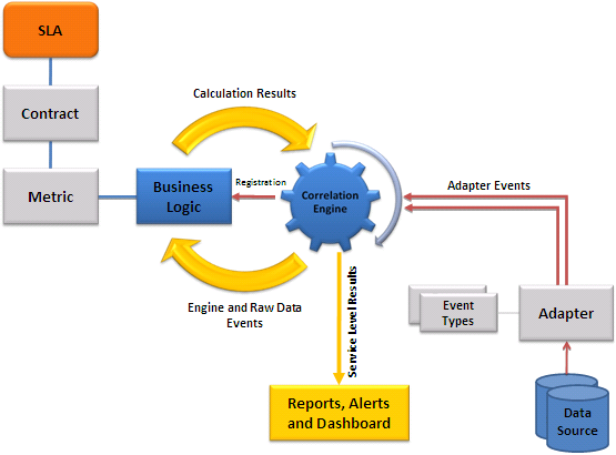

The data flow within the system is in the form of Events. Where an Event is, an information message created by the Adapter based on source data and is in a format that can be used by CA Business Service Insight for its service level calculations. Raw data always consists of Events.
The focus of the design must therefore be on this Event flow within the system.
Before modeling the data requirements, both the Business Logic Expert and the Data Source Expert need to have a solid understanding of Events and their flow within the CA Business Service Insight system. The following diagram illustrates in high level this basic Event flow.
The previous diagram depicts how Events are retrieved from the data source by the Adapters and normalized into a standard Event structure defined as the Event Type. These Events are sent by the Adapters to CA Business Service Insight. These Events are referred as Raw Data Events.
The Business Logic calculations in each Metric are based on a subset of the Raw Data Events. The Business Logic therefore requests this subset by performing registration.
Based on the registration statement, the Correlation Engine sends only the Raw Data Events relevant for business logic calculations.
Additional types of Events sent to the business logic are the Engine Events. All concepts involved in this process are discussed in detail in this chapter.
This section focuses on the following parts of the diagram:
