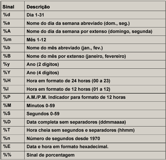

<InputFormatField Name="date" Type="time"
TimeFormat="%d/%m/%Y %H:%M:%S"/>
