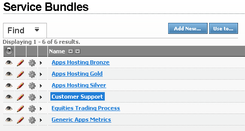

When using a service level template to deploy some Customer Support Metrics to a Contract, it is possible to select required metrics from an existing definition.

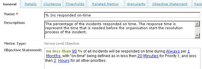

Inside this service level template, there is a Metric called '% of Incidents responded to on time'. You can see that there is a level of subjectivity here, in that the 'on time' component may be open to question. The following example explains the measurement made in this Metric:

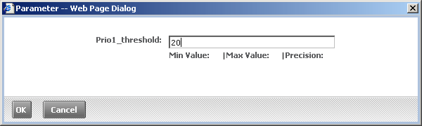

The objective statement displayed at the bottom of the Metric's General tab (or alternatively on the Objective Statement tab) shows all of the parameters exposed in this Metric. In the previous figure, the definition of 'on-time' is given as 20 minutes. This is a parameter which is customizable to allow our own reinterpretation of this pre-defined Metric. To change this value, you can click the 20 Minutes parameter link.
In this way, the new Metric created from the service level template can be customized without the need for modifying the underlying business logic of the Metric. Note that this also assumes the business logic is written in such a way as to incorporate these parameters in the service level calculation.
