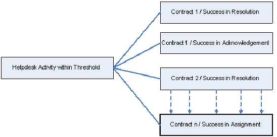

Business Logic modules are independent code components that enable re-use of the same code base by other Business Logic. Modules can also include other Modules, so the hierarchy levels can be multiple. When using Modules, the code is contained in one place and is re-used by each of the other components which link to it. This re-use of code sections eases the maintenance by eliminating code duplication and making it possible to apply system-wide logic changes quickly and easily.

The above diagram depicts a Module that calculates the success rate of helpdesk activity to meet a target within given thresholds. To implement it as described, it is necessary to define two parameters, known as Metric Parameters: one that defines the type of helpdesk activity, and another for the threshold to compare against (see definition of Metric Parameter in Cases to be Considered During the Modeling Process).
