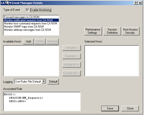

To configure the Event Traffic Controller, select Expert Interface, Automation, Events Interface, CA NSM Event Manager Events from the Configuration Manager main window. The CA NSM Event Manager Events dialog displays:
This dialog allows you to configure the event types listed in the Type of Event field. The options displayed on this dialog depend on the type of event you select.
For detailed information for each field, see the dialog Help.
Important! To ensure that the changes you make to the configuration of the Event Traffic Controller take effect, you must restart CA Automation Point.
