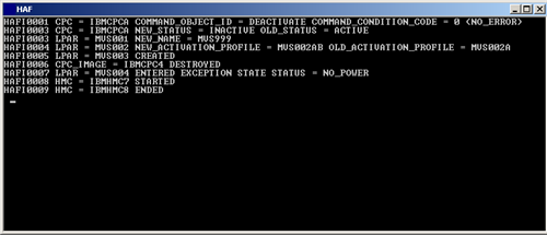

The following is an illustration of a HAF window collecting consolidated hardware messages from your HMCs.
