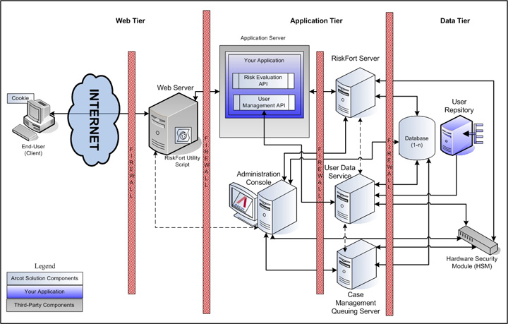

You can install RiskMinder on a single system or you can distribute its components across multiple systems, as discussed in later sections in the guide. However, to ensure maximum security and integrity of data and transactions, use the three-tier architecture that is shown in the following figure:
The following subsections discuss the components of these layers.
