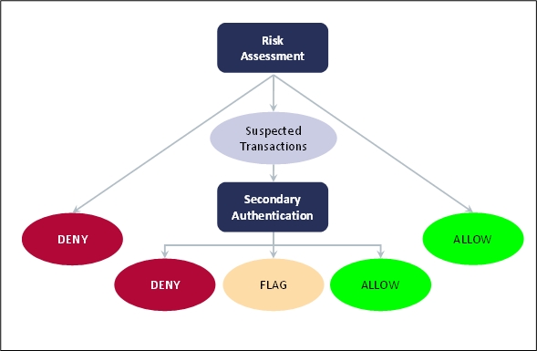

Based on the data that is received, RiskMinder generates any of the following advice:
For example, when a user registered with RiskMinder attempts a transaction from a device that is not yet recognized by RiskMinder, then the user must undergo secondary authentication (such as OTP or QnA) with your application.
The following figure illustrates the advice that RiskMinder returns.
