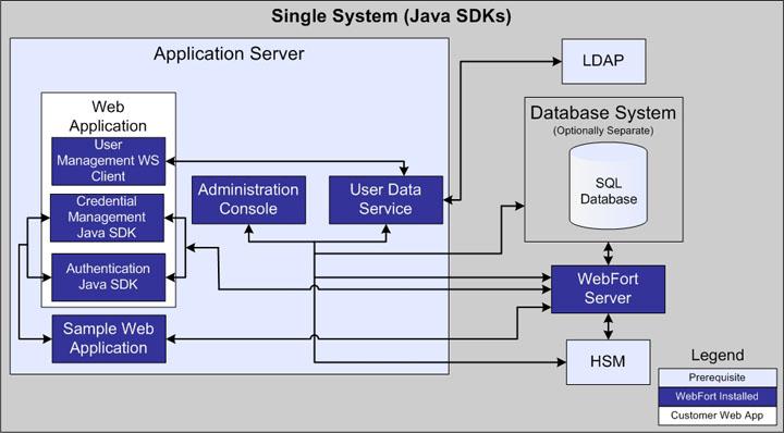

The following figure illustrates deployment of AuthMinder Server and Java SDKs on a single system.
Note: The use of a Web server to deliver HTML pages for the application server is optional and is transparent to AuthMinder. In production deployments, this approach is used to improve Application Server performance and security. See the documentation of your Application Server for detailed information.

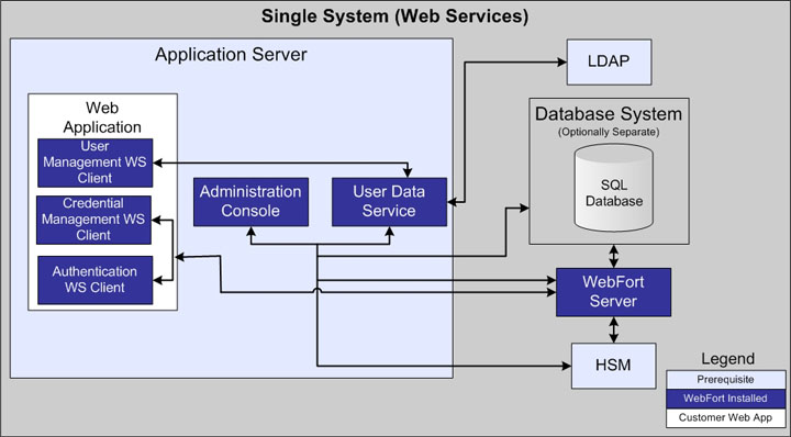

If you plan to deploy Web services, then the following figure illustrates AuthMinder Server and Web Services on a single system.
Note: Because all Web Services are now built into the AuthMinder Server module itself, you just need to install the AuthMinder Server on the target system and generate the requisite client stubs. No further configuration is required.
