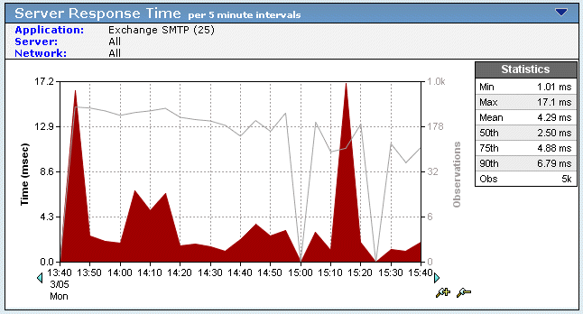

An increase in the Server Response Time and in the number of Observations is a strong indicator that a performance problem is associated with the server. This conclusion can be reinforced by correlating it with other relative data.
Performance problems associated with a server should be visible across all network sets and aggregations -- both local network sets, including users in the same building as the data center, and remote network sets, including users across WAN connections.
If both the Server Response Time and number of Observations peak at the same point in time as the observed performance issue, review the following data sets for the same point in time:
