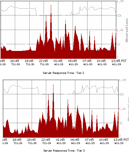

The following charts illustrate a Server Response Time dependency between Tier 2 and Tier 3 of an application architecture. The SRT of the Tier 2 server follows the SRT of the Tier 3 server during periods of high response times.
Trailing data points between the two tiers indicate that the Tier 3 server performance affects the Tier 2 server performance. The Tier 3 server is a bottleneck in this application architecture.
When the Tier N application latency has the same general curve as the Tier N+1 application latency during peak latency spikes, the Tier N application is probably being adversely affected by the Tier N+1 application.
