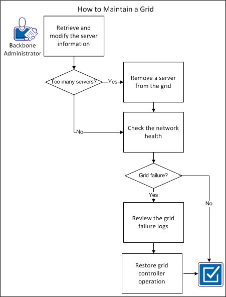

As a Backbone Administrator, you want to perform administrative tasks and advanced operations on a grid. These operations include retrieving server information, checking the network health, and reviewing grid failures. BFC Maintainers can perform these tasks regularly.
The following diagram shows how to maintain a grid in a typical environment:
Diagram that shows how to maintain a grid.
  1. Retrieve and modify the server information.
  2. If you have too many servers, remove a server from the grid.
    For example, you want to change the minimum number of required servers from 5 to 4 because of underutilized resources.
  3. If you want to detect problems in the grid, check the network health.
  4. If the grid fails, complete the following steps:
    1. Review the grid failure logs.
    2. Restore grid controller operation.
